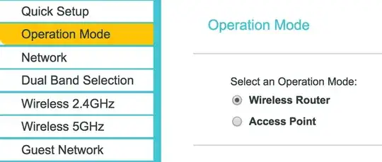

I have had a similar issue with the TP-Link Archer C50. Bonjour devices would just not show up. I had originally set up the router as an access point, basically extending an existing LAN with additional WiFi.
What solved the problem for me was configuring the router as a router, that is, selecting this option:
Before enabling it, you will have to plug in something into the WAN port. Then, after enabling it, unplug the cable, wait for the router to restart. Now connect your PC again, navigate to 192.168.0.1 (the router's default address), and change the Network » LAN address of the router to something other than your existing router's IP. Restart, then go to DHCP and disable the built-in server. Restart once more and the router should work.
