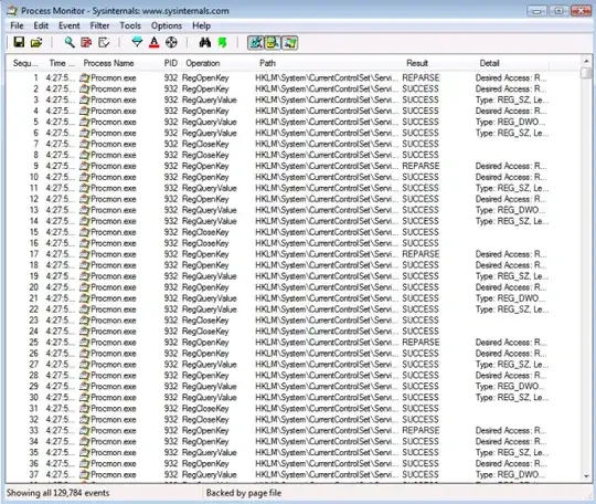

Run the installer and watch it with Sysinternals Process Monitor. You can filter the data so that only operations done by the installer are shown. You can even filter down to whatever operations you want to see (RegWrite, RegQueryValue, etc) and save the capture for later viewing.
alt text
Process monitor is freeware.

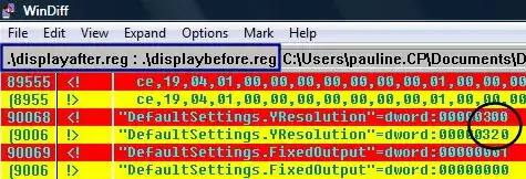

You could also use WinDiff. You can save exported registry files and then compare them afterwards:
alt text
WinDiff is free and open source.

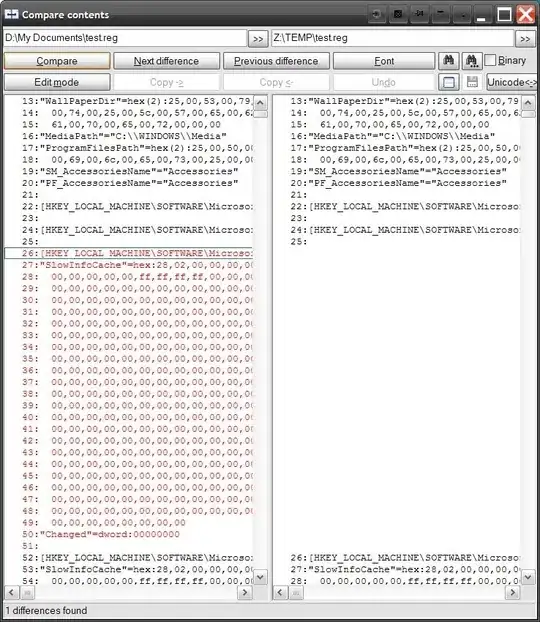

if you happen to have Total Commander, this is pretty easy:
  1. export the registry before the installation and after the installation (save with the same name in different folders)
  2. open both folders in Total Commander, highlight the file on one side, go to Files > Compare By Content... voilá:
Total Commander is shareware, try before you buy.
