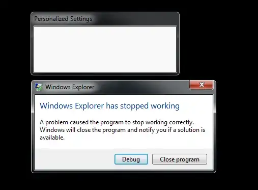

My Windows 7 desktop PC, built by me, started acting very weird in the last couple of days. I use it quite often, about half of the time through TeamViewer. Explorer would crash and restart randomly, almost always through TeamViewer. This made me suspect that TeamViewer was the problem but I have reproduced it with and without TeamViewer several times. The only way I can seem to get the problem not to occur is by booting into Safe Mode.
I have used CCleaner and Malwarebytes to make sure it wasn't a registry error or malware causing the problem, and I have tried the fix in the seemly related issue here as well every other fix I have found online including removing security updates KB980408 and KB2926765 as well as using "sfc /scannow" and a bunch of other things I can't remember.
More recently when I try to start explorer it is popping up a small window that says "Personalized Settings" on the top, but is completely empty and crashes instantly. The only way I can get it to disappear is to kill the explorer.exe process. I wish I could take a screenshot but I can't seem to open paint or even find the exe. I have tried restarting it, I have tried starting it while the personalized settings window was open.
I have come up with two lists of processes the first is the list of active processes when I boot into safe mode and explorer seems to work fine. The second is the list of processes that I can narrow it down to in normal boot and still replicate the problem. There is one process that I can't seem to close. NisSrv.exe which is describes as "Microsoft Network Realtime Inspection Service". When I try to close the process NisSrv.exe it says "The operation could not be completed. Access is denied." When I try to close the related service it gives the same message.

Personalized Settings Error
Here is the event data xml from event viewer for the error I am getting.
<EventData>
  <Data>explorer.exe</Data>
  <Data>6.1.7601.17567</Data>
  <Data>4d672ee4</Data>
  <Data>vrfcore.dll</Data>
  <Data>6.3.9600.16384</Data>
  <Data>5215f8f5</Data>
  <Data>80000003</Data>
  <Data>0000000000003a00</Data>
  <Data>12e4</Data>
  <Data>01cfb84fa70f89dc</Data>
  <Data>C:\Windows\system32\explorer.exe</Data>
  <Data>C:\Windows\SYSTEM32\vrfcore.dll</Data>
  <Data>e5957093-2442-11e4-9f8a-94de806ed9cb</Data>
</EventData>

And the general error details
Faulting application name: Explorer.EXE, version: 6.1.7601.17567, time stamp: 0x4d672ee4
Faulting module name: vrfcore.dll, version: 6.3.9600.16384, time stamp: 0x5215f8f5
Exception code: 0x80000003
Fault offset: 0x0000000000003a00
Faulting process id: 0xc38
Faulting application start time: 0x01cfb84e5e852c5f
Faulting application path: C:\Windows\Explorer.EXE
Faulting module path: C:\Windows\SYSTEM32\vrfcore.dll
Report Id: 9dc19e6d-2441-11e4-9f8a-94de806ed9cb

The problem turned out to be Visual Studio trying to debug the explorer crash that caused it to never be able to start. I uninstalled Visual Studio and rebooted and explorer then crashed on boot but immediately restarted and worked fine. I have isolated the crash on boot and traced it to an error with Synergy found here http://synergy-project.org/spit/issues/details/3980/

  • Is Windows 7 fully patched? Do you get the same issue if you [perform a clean boot](http://support.microsoft.com/kb/929135/en-us)? Did you [check the system event log](http://windows.microsoft.com/en-us/windows/open-event-viewer#1TC=windows-7) for further details? – and31415 Aug 15 '14 at 09:15
  • It is hard to tell for sure if windows is fully patched because I can't start control panel or windows update either. When I run the command `wuauclt /detectnow` I get no output. I have updated the question with event viewer details for the error. I am about to run clean boot so I will further update the question when that is done. – Spaceman Spiff Aug 15 '14 at 20:00
  • No luck with the clean boot. – Spaceman Spiff Aug 15 '14 at 21:18
  • The `vrfcore.dll` mentioned in the event log is part of the Microsoft Application Verifier software which is bundled with the Windows 8.1 SDK/WDK (in fact, the file version is `6.3.9600.16384`) and Visual Studio 2013. Have you ever installed any of these? – and31415 Aug 16 '14 at 11:19
  • Yes I got visual studio 2013 through the dreamspark program. – Spaceman Spiff Aug 16 '14 at 17:30
  • capture a dmp with WER and share it (compress the dmp as 7z): http://msdn.microsoft.com/en-us/library/bb787181%28VS.85%29.aspx – magicandre1981 Aug 17 '14 at 06:11
  • If you haven't already, open a command prompt as administrator and run this command: `chkdsk %systemdrive% /r` Regarding the WMI error (`Event filter with query etc.`), check [this article](http://support.microsoft.com/kb/2545227/en-us). As for Windows Search, try [rebuilding its index](http://www.sevenforums.com/tutorials/17880-index-rebuild.html). – and31415 Aug 17 '14 at 07:21
  • have you captured the dump of the Explorer crash? – magicandre1981 Aug 18 '14 at 15:51
  • Just added the dump sorry for the delay. chkdsk came back clean and I attempted the fix for the WMI error and the search index with no luck. – Spaceman Spiff Aug 18 '14 at 16:15
  • the WER log is useless, I need the actual dmp file to open it inside a Debugger – magicandre1981 Aug 19 '14 at 04:17
  • @and31415 it was Visual Studio that was causing the repeated crash. I have updated the question with the details of what happened. If you post and answer I will accept it and award you the bounty. Thank you everyone for your help and patience. – Spaceman Spiff Aug 19 '14 at 15:40
Quick analysis
The vrfcore.dll library file mentioned in the log is related to the Microsoft Application Verifier tool, which is part of the Windows 8.1 SDK/WDK (in fact, the file version is 6.3.9600.16384) and is also included with Visual Studio 2013.
Quoting the documentation:
Application Verifier assists developers in quickly finding subtle programming errors that can be extremely difficult to identify with normal application testing. Using Application Verifier in Visual Studio makes it easier to create reliable applications by identifying errors caused by heap corruption, incorrect handle and critical section usage.
Source: Application Verifier
Workaround
Although it's not an actual solution, uninstalling Visual Studio can serve as a temporary workaround. Before doing so, you might try to remove just the Application Verifier by following these steps:
  1. Open an elevated command prompt.
  2. Run one of the following commands depending on the Windows version you're running:
    • x86 (32-bit)
      msiexec /uninstall {13A3E02D-36D4-BBD6-0BBD-D0BFDBEA0079}
    • x64 (64-bit)
      msiexec /uninstall {77F3D72C-465F-BD51-890E-CC3914B1365F}
  3. Restart Windows.
Note You might want to ensure that you have all Visual Studio updates installed, which can include bug fixes to specific issues.

  • Good screen grab. I haven't unfortunately come across the Autoruns error you experienced but I've edited my answer and given some more suggestions that may help. – user319647 Aug 15 '14 at 22:05
