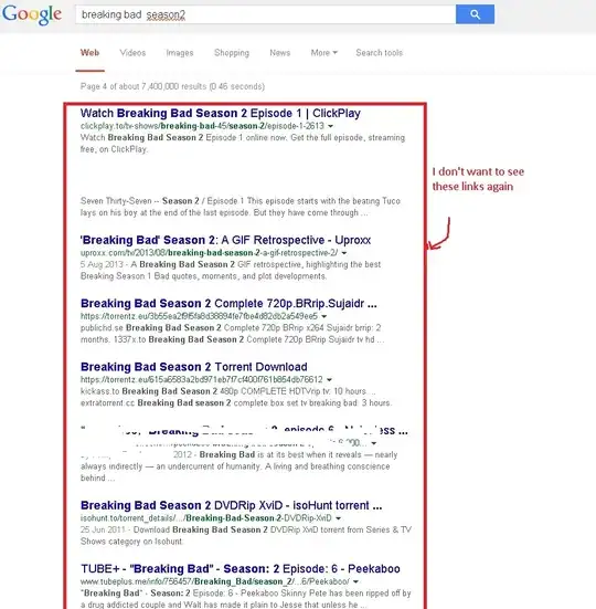

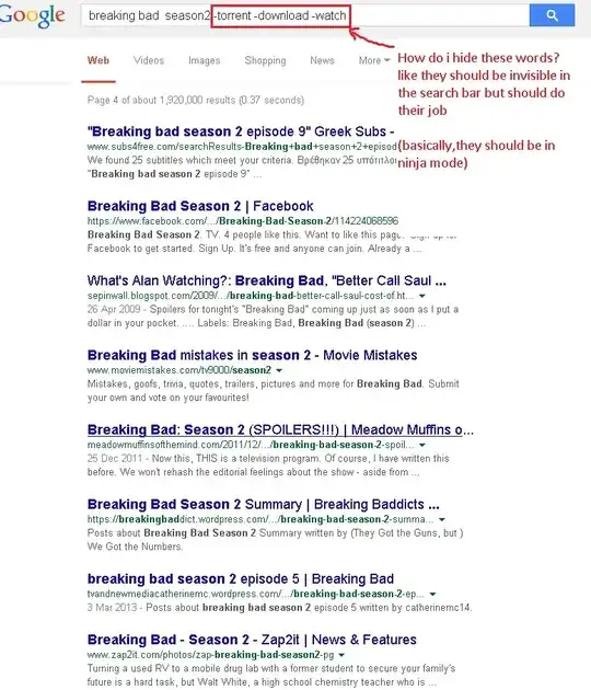

I am not fluent in English, so I will explain using 2 searches contained in the images below with Breaking Bad tv series as an example ...
Search 1:
Search 2:
If someone searches Google or any other search engine this phrase (-torrent-download-watch) should be automatically and invisibly added.
Are there any MITM proxy Gurus around here that can help me? If creating the script is hard, I can (please tell me if this is against the rules) hire someone.
