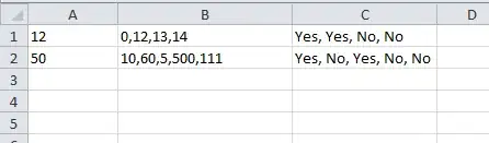

My worksheet looked like
And after I run the VBa
Excel kept formatting the columns as number. It must remain as Text!

  • Yes, the column is already set as Text. Dave thanks for the solution but I dont know how to run VBa. May be its quite easy for you or for me to google that but for first time I need a demo and what better than asking to a expert like you. – Raw Aug 22 '14 at 13:48

  • Its working...thanks @Dave. It solved 1st part of my problem. – Raw Aug 23 '14 at 07:04
