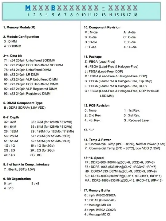

Did you try to Google for 'Samsung RAM part number'. The first hit (on my search) lead me to this site (archive), which exactly answers your question. Here is a picture of what's there:
Samsung DDR3 part number decoder
But, as stated by @user2196728 in the comments, part numbers are not the numbers you need to worry about when you're replacing the RAM. The following spec's must be the same for the RAM to work:

1051 and 1110 are the time codes when the chips were made: 1051 = week 51 of 2010; 1110 = week 10 of 2011. The format is usually YYWW, where YY is the year and WW is the week within the year.
