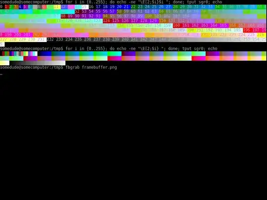

You can use e.g.
echo -ne "\E[2;32} "
which should print a blue space. (32 is the 32nd colour in the default 8-bit colour table which seems to be blue.)
(Of course you can also use \x1b or \033 instead of \E to represent the escape character.)
To view all 255 colours you can use for i in {0..255}; do echo -ne "\E[2;$i} "; done; tput sgr0; echo or for i in {0..255}; do echo -ne "\E[2;$i}$i "; done; tput sgr0; echo which also includes the number of the colour.
Example: colour output example captured with fbgrab from framebufferconsole

  • Do you have a reference for the default colour palette? – Attie Oct 06 '18 at 22:52
  • No, but you could try something like `for i in {0..255}; do echo -ne "\E[2;$i} "; done; tput sgr0; echo`, this should print 255 coloured spaces and reset every text-colour-related setting to defaults in the end (`tput sgr0`). – Kai Oct 09 '18 at 05:31
  • Indeed - perhaps you could add this to your answer with a screenshot of the result? Numbers in the color would be even better :-) – Attie Oct 09 '18 at 09:21
    Done, I added both one-liners (-: – Kai Oct 10 '18 at 07:38
