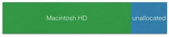

I have created a partition for OS X (200GB journaled, encrypted) and also left 51GB unallocated for Boot Camp later on.
After I successfully installed OS X 10.9, I wanted to install Windows 8.1 with Boot Camp. But Boot Camp only wants to shrink the Macintosh HD partition, and doesn't want to use the free space left on the drive. So I switched to Disk Utility, to try it that way. But in Disk Utility I wasn't able to create a new partition (if I press the 'partition' button it just doesn't do anything).
Next, I tried to switch of File Vault 2, let it decrypt itself, restart, and then try it again in internet recovery mode. But still, I cannot expand the Macintosh HD-partition or create a new partition.

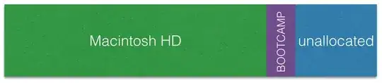

Here is what I've done:
I started with this situation, I formatted 200GB of my drive for OS X and left 51GB 'unallocated' for a Bootcamp partition later. I turned on File Vault and installed my programs. I could not create a new partition out of the unallocated space with Disk Utility or the Bootcamp Utility.
Since Bootcamp could not create a partition from the unallocated space, I chose to split the Macintosh HD partition into 2 partitions with Bootcamp.

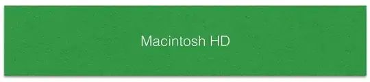

After that, I deleted the bootcamp-volume with Disk Utility. After deleting the Bootcamp-volume, disk utility expands the main-os partition to its maximum size by using all unallocated space. That solved the problem!

  • Nice find, Sherlock :-) – Arjan Sep 06 '14 at 12:27
  • If anyone ever uses this trick *without* first decrypting, then please let us know here, or at [How do I resize a FileVault 2 encrypted partition?](http://superuser.com/questions/315803/how-do-i-resize-a-filevault-2-encrypted-partition) – Arjan Sep 06 '14 at 12:43
  • This also works splitting the encrypted Macintosh HD in two and merging the result with the first one by pressing "-". Meh, what a mess. – cedivad Feb 23 '15 at 21:38
