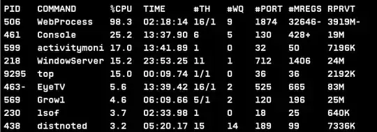

Example
Firefox looks like this:
Should look like this, and looks like this if I do a shutdown and then start again:
Firefox OK

  • Can you post a screenshot of the problem? – Doktoro Reichard Sep 09 '14 at 10:55
  • @DoktoroReichard I tried to make it as explicit as possible with the pictures, please let me know if you think something else could be more approriate – SRKX Sep 09 '14 at 11:04
  • Does this only occur in Firefox or are there other applications involved? Also, is the first image zoomed on purpose or it appears as is? – Doktoro Reichard Sep 09 '14 at 11:05
  • The first step in the troubleshooting process seems clear, uninstall your display drivers, then install them again. What GPU are you using ( Intel, Nvidia, AMD )? – Ramhound Sep 09 '14 at 11:06
  • @DoktoroReichard I haven't zoomed at all, just used the snipping tool. It does it for Firefox, Chrome, Excel, Bitdefender ... I can remove it on some of them by disabling DPI settings, but even Windows' interface is blurry. – SRKX Sep 09 '14 at 11:10
  • @Ramhound I added the config in the question. – SRKX Sep 09 '14 at 11:12
    Seeing as though this affects more than Firefox, I'll leave [this](http://superuser.com/q/804949/228536) question for reference (essentially Firefox picks up the DPI setting in Windows and uses it with zoom). Either DPI settings are coming in the way or you have a resolution that doesn't match well with your screen size. – Doktoro Reichard Sep 09 '14 at 11:18
