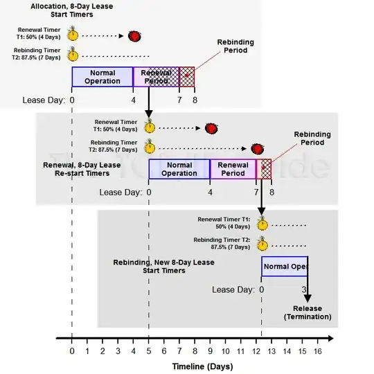

This diagram illustrates the DHCP life cycle using an example that spans three leases:
  • The initial lease has a duration of eight days and begins at Day 0.
  • The T1 and T2 timers are set for 4 days and 7 days respectively.
  • When the T1 timer expires the client enters the renewal period, and successfully renews at Day 5 with a new 8-day lease.
  • When the second lease T1 timer expires, the client is unable to renew with the original server.
  • It enters the rebinding period when its T2 timer goes off, and is granted a renewed 8-day lease with a different server.
  • Three days into this lease it is moved to a different network and no longer needs the leased IP Address, and voluntarily releases it.

  • Following the diagrams: 1) Isn't renewal meant to happen immediately after T1 ? How long after T1 goes off will it try ? Why would it take more than 4 days ? Would it take the whole period until T2 to retry? 2) Does the client when failing to renew won't automatically try to rebind but wait for T2 to end for it to happen ? This means the client can stay offline for that period and seems unwanted. – elig May 30 '19 at 11:13
  • @elig Renewal start at t1 (which is 50% of the lease time). It could take another 3 days if the DHCP server is not available (until t2 fires). It still has the lease during the renewal period, even if t1 renewal fails as the lease does not run out until 8 days and t2 kicks in at 7 days (with a day left on the lease). – DavidPostill May 30 '19 at 17:26
