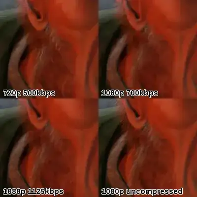

Here's a comparison of the same region cropped from both frames after scaling to 720p (frame 2097). Look at the fingers, heads and the piece of equipment hanging from the ceiling: even going from 500 to 700 kbps makes a noticeable difference. Note that both images are already scaled to 720p.
Different pictures of frame 2097 side-by-side

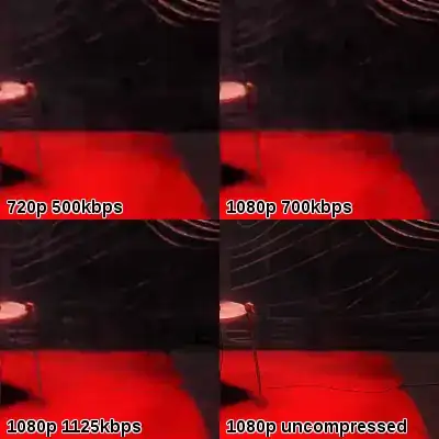

Frame 3705. Notice rug's edge and the cable:
Different pictures of frame 3705 side-by-side
