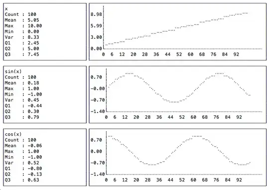

I like termeter with plenty of default options and features.
termeter can visualize data in the terminal. Data can be passed by pipe or file.
 seq 100 | awk 'BEGIN{OFS="\t"; print "x","sin(x)","cos(x)"}{x=$1/10; print x,sin(x),cos(x)}' | termeter

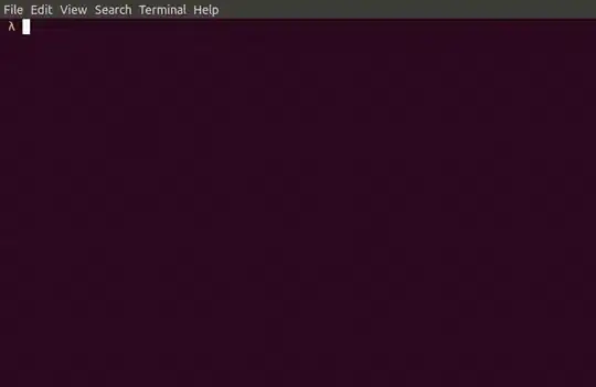

Install pip install pipeplot
Use ping ya.ru | grep --line-buffered time | sed -u -e 's#.*time=\([^ ]*\).*#\1#' | pipeplot --min 0
See: gif
