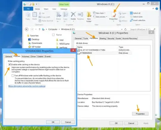

By looking at the trace I can see that you disabled Write Caching for the HDD.
This slows down the HDD extremely. Go to the device manager and enable Write Caching again:
This should improve the performance.
