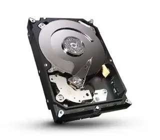

I'm shopping for new hard drives and all the stores (Amazon, Overstock, Newegg, etc.) now show product pictures like this:
Typical product photo used by hard drive vendors
I can find no information in the product descriptions or in Google searches stating that this is just another marketing gimmick and that the drives really are enclosed.
Here's an example hard drive page on Amazon.
The replacement drives are to go into an external array (Drobo) that blows unfiltered air over its drives. Last I heard, even the tiniest bit of dust can trash drive components, but maybe technology has changed on me again?
  • Is dust no longer a concern for 2 and 3 TB drives?
  • Are these units really covered? I don't want to spend a few hundred bucks to order them before knowing.
  • If they really are covered, what reason would a marketing team have to only show pictures of the guts?
  • If they are not covered, how do I buy one that is?

    Look closely on the edge. You'll find six holes used for the screws which will be holding the cover in place. This way of displaying drives is not new. First time I saw it was more than a decade ago. It does tell you a bit more about what product you are buying than a picture with the cover attached would. From a picture with the cover attached, most people couldn't even tell the difference between a disk and an SSD. – kasperd Oct 21 '14 at 06:55
    If it helps, I work at Seagate and can confirm that I know of no drives which are shipped to consumers without a case and there have not been any for about 20 years at least as far as I know. The reason being is that the platters are so sensitive to dust they need to be kept in a clean room when open to avoid damage. – Vality Oct 22 '14 at 16:59
    Those are just marketing pictures. No drives are shipped that way. – RockPaperLz- Mask it or Casket Oct 24 '14 at 21:26

No, hard drives are in sealed enclosures and these images are marketing shots to give you an idea of the engineering inside.

    I don't have evidence or links, just the knowledge that an open hard drive like that would break instantly. – Paul Oct 21 '14 at 05:36
    @BrockAdams: evidence: look at how they are actually assembled in the factory: https://www.youtube.com/watch?v=L4qBl8x3tC0 ... they are working in dust-free rooms, with LOTS of protection so that anything their body emits wont hit the disks. – akira Oct 21 '14 at 05:51

Comparing the TigerDirect page for a Seagate ST2000DM001 to the Amazon page for the ST2000DM001, we see that the TigerDirect page includes a few more pictures for that exact model number.
One of the pictures shows the drive with the case on.
This suggests that the other 3 stores you checked just decided, for whatever reason, not to show the product as shipped. This would be a marketing decision. The drives either still come enclosed or the Seagate ST2000DM001 is different from different stores -- which doesn't seem likely.

@Paul is absolutely correct.
Hard drives need to be enclosed (I'd say sealed, except they are not quite sealed - but the tiny area which is not sealed is behind a heavy filter).
It makes sense that drives need to be sealed when you realise how they work. The drive head floats very slightly above the platter to read the information. The thing is that that gap is tiny. A finger print or speck of dust is several orders of magnitude bigger then the distance between the head and the platter, so even the smallest amount of dust would cause the drive to die very quickly. Similarly it makes it easy for the head to be knocked, and even the slightest knock can damage the drive.

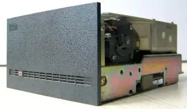

This is not new. Here's an ad for a 10 MB HDD which also most definitely did not ship with open disks.
https://plus.google.com/+DeryaUnutmaz/posts/hUWkX1Ukhiy
ad for 10MB HDD
Here's how a 10MB HDD looked like
an actual 10MB HDD

For display purposes only.
The read-write heads move across the disk, flying on a thin film of air about 3-7 millionths of an inch thick.
Finger prints and the finest dust will bridge this, causing a head crash.
A human hair is a mountain in size in comparison at about 0.5-6 thousandths of an inch
Most drives available have a sealed container with a micro-filtered breather hole to keep out the dirt. The "most" excludes certain fully environmentally sealed technologies.

Mechanical hard drives will always come in sealed metal enclosures.
The only exception I know to the "solid metal enclosure" rule, was the Western Digital Raptor X, a hi-performance 150Gb 10k RMP HDD: it was sealed with a transparent plexiglas enclosure, so you could effectively see the spinning disks and the moving head.

Also note the Amazon page you linked is for the DT01ACA200. That's a 1TB per platter drive, it has two platters and four heads yet the photo quite clearly shows 3 platters -- the picture does not change between the 2TB and the 3TB model (DT01ACA300) at all. That shows something is off.
In fact, the picture is very very likely to be of the 500GB 2.5" AV Western Digital drive from 2010: http://www.digit.in/storage/wd-av-25-2-5-inch-sata-hdds-with-silk-stream-advanced-format-technology-at-rs-2750-to-rs-4400-4294.html http://thumbs2.picclick.com/d/l400/pict/351079558689_/WD-25-500GB-16MB-SATA-II-Laptop-Notebook-MAC-PS3-Hard.jpg http://hardver-teszt.hu/news.php?newsID=681 and the official PDF at http://www.wdc.com/wdproducts/library/SpecSheet/ENG/2879-771362.pdf also has a very very similar pic. Needless to say in reality WD AV 2.5" it shipped sealed.
The marketing team sometimes doesn't produce any picture at all. If you do a Google image search for the image from the Toshiba page on Amazon you linked to, you'll find that same image for many other drives. It's basically clip art. There are so many models of hard drives, it's such an easily identifiable image and there's really not much marketable difference between the physical appearance of their guts (nobody really cares what the inside of a mechanical drive looks like at this point - it's on the same level as a picture of a DVD or, say, a piece of plywood on a home improvement store's web site), that many times there just isn't a special image, and stock art is used.
