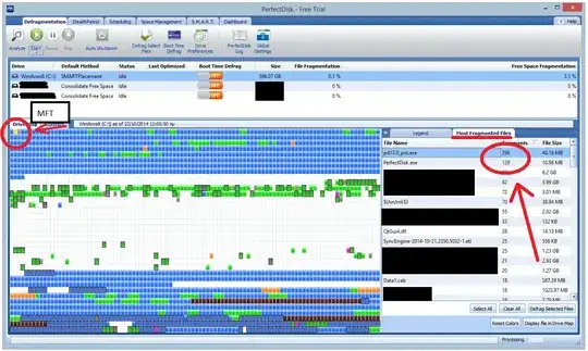

After the last partition resize, I defragged using Defraggler and the windows utility 2 times. This took some 5 hours each time and since the problem still remains I installed Perfect Disk which revealed two strange issues:
  • Defraggler finds the MFT in the middle of the partition and Perfect disk at the beginning of the drive.
  • The most fragmented files are the last two files copied to the disk. The Perfect Disk itself. How can this be true, it was just copied into a disk with lots of free space!

(bigger image here) enter image description here

You might want to try defragmenting system files like the page file and MFT at boot time. Defraggler offers this option; it will run when you reboot your computer, on a text-mode screen before the Windows lock screen comes up. You can access this functionality under Boot Time Defrag in the Settings menu. I've done this before and it successfully defragmented the MFT.
Running Windows command-line defrag with the undocumented /b option, which optimizes for boot speed, may also help.

  • pagefile isn't being used, I have lots of RAM. I will try defragging both of them during startup and I'll post the results. Thanks for the suggestions – Odys Oct 21 '14 at 22:33
