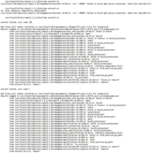

Eventually - frustrated, I moved on and would come back to that issue later. So then I was trying to sudo gem install nokogiri and over and over it would fail and spit out this same error (a lot of repeats about the builder.rb failing to build the gem native extension - followed by a bunch of repeated stacktraces Logs Gist
nokogiri Install Errors nokogiri install errors

It looks like my process keeps forking, which then made sense for this ONE line in my previous picture (see "nokogiri install errors picture")
sh: fork: Resource temporarily unavailable
