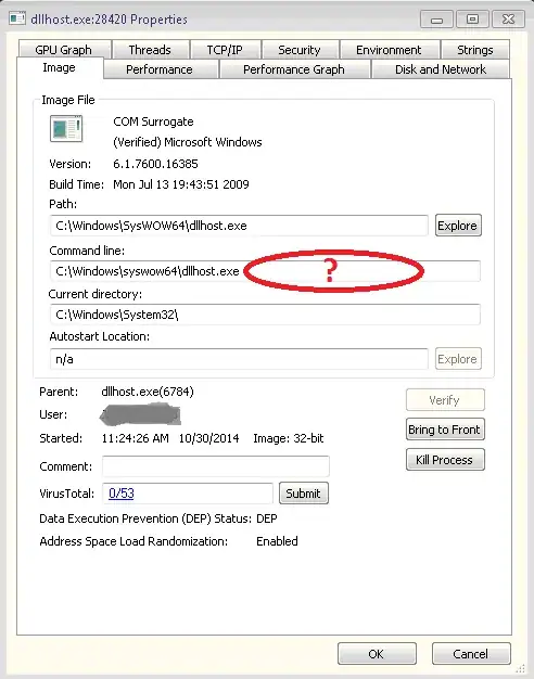

I have multiple dllhost.exe processes running on my Windows 7 computer: enter image description here
Every one of these image's command line is missing (what I am thinking is) the requisite /ProcessID:{000000000-0000-0000-0000-0000000000000} command line option: enter image description here
Question: How can I determine what's actually running in this process?
It's my belief that if I can identify the actual application doing the work inside these dllhost.exe processes I'll be able to determine if my system is infected or not (see below).

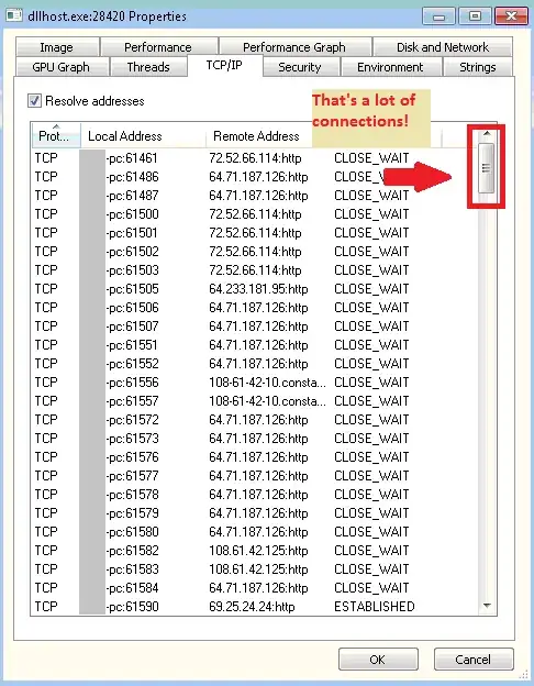

These DLLHOST.EXE instances look suspicious to me. For example, several of them have a lot of open TCP/IP connections:
Process Monitor shows and absurd amount of activity. Just one of these processes generated 124,390 events in under 3 minutes. To make matters worse, several of these dllhost.exe processes are writing approximately 280 MB of data per minute to the user's TEMP and Temporary Internet Files folders in the form of folders and files with random four character names. Some of these are in use and cannot be deleted. Here's a filtered sample:

It's a Fileless, Memory-Injecting, DLL Trojan!
The credit for pointing me in the right direction goes to @harrymc so I've awarded him the answer flag & bounty.
As far as I can tell, a proper instance of DLLHOST.EXE always has the /ProcessID: switch. These processes don't because they're executing a .DLL that has been injected directly into memory by the Poweliks trojan.
According to this writeup:
...[Poweliks] is stored in an encrypted registry value, and loaded at boot time by a RUN key calling rundll32 process on an encrypted JavaScript payload.
Once [the] payload [is] loaded in rundll32, it tries to execute an embedded PowerShell script in interactive mode (no UI). That PowerShell scripts contains a base64-encoded payload (another one) which will be injected into a dllhost process (the persistent item), which will be zombified and act as a trojan downloader for other infections.
As noted in at the beginning of the above-referenced article, recent variants (mine included) no longer start from an entry in the HKEY_CURRENT_USER\...\RUN key but are instead hidden in a hijacked CLSID key. And to make it even harder to detect there are no files written to disk, only these Registry entries.
Indeed (thanks to harrymc's suggestion) I found the trojan by doing the following:
  1. Boot to Safe Mode
  2. Use Process Explorer to suspend all of the rouge dllhost.exe processes
  3. Run a ComboFix scan
In my case the Poweliks trojan was hiding in the HKEY_CLASSES_ROOT\CLSID\{AB8902B4-09CA-4bb6-B78D-A8F59079A8D5} key (which is has to do with the Thumbnail Cache). Apparently when this key is accessed it executes the trojan. Since thumbnails are used a lot this had the effect of the trojan coming to life almost as quickly as if it had an actual RUN entry in the Registry.
