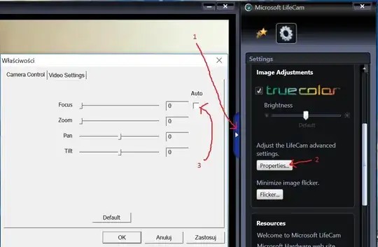

For me, on Windows 10 64-bit the following procedure helped to disable autofocus completely, also after restart:
  1. Upgrade Firmware: Download it from Microsoft’s official site here.
  2. Install LifeCam Software: Use the link above to find it.
  3. Disable Autofocus in LifeCam Software Settings: see the screenshot below for an exact step-by-step instruction.
Now these settings should be used in all applications using the camera, including your video capture app, Skype, etc.
Screenshot showing how to disable autofocus in LifeCam software
