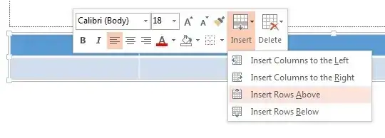

If you right click on the row or column you want to insert before, you see the context menu which has insert and delete options. Selecting the appropriate one of those gives you the columns/rows left/right or above/below. See picture. This at least means you don't have to go to the ribbon.
Context Menu allows row insertion where you clicked
The only shortcut key for table row insertion I know is TAB, which adds one row on the end of a table if you happen to be in the last cell of the table.

  • Thank you. Strange I never realized this one. The interesting part is that it's docked unless you leave your mouse away; so if you have multiple rows to add, it is easier to repeat. – Gerard Yin Feb 18 '15 at 10:29
    You should highlight that part about using tab in the last cell of the table, which is what I needed for my usecase, at least. – eirikdaude Nov 30 '21 at 11:39
