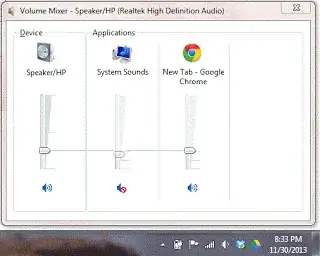

Volume for audio and video sounds too quiet in Chrome, e.g. on YouTube. I have tried restarting it (via the actual exit option) and then I tried restarting the computer.
Running Windows 8.1.
Volume mixer looks normal.

To turn up the volume in Chrome:
  1. Start playing sound in Chrome (e.g. Music or YouTube)
  2. Click volume icon in taskbar
  3. Click Mixer
  4. Adjust the volume level for Chrome.
  5. If you raise it to the Speaker volume, they should become linked.

Open chrome browser:
  • Go to Start > Search and type vol.
  • Click on Adjust system volume.
You should see a volume slider specifically for Google Chrome (this only shows up if the browser is currently open).
Test volume in browser - adjust Chrome setting:
Volume Mixer

  • A thousand thank yous! I had no idea that windows had application specific volume controls build into the volume mixer. Wow! That was my problem. – RonC May 31 '19 at 16:56
