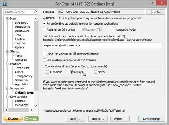

Click where? Have you enabled DefaultTerminal feature? It has a confirm option.
DefTerm options

  • I would like to be able to click the icon in Explorer to do this. Yes, I have enabled the Default Terminal option. I have also enabled 'Aggressive Mode' and 'Register on OS start up' and 'Use existing ...' options. The text box has 'explorer.exe' and everything else on that page is disabled. – krowe2 Nov 20 '14 at 21:57
  • "Everything else" is enabled of course as on screenshot. – Maximus Nov 20 '14 at 22:02
  • That did it of course. Thanks. Not sure how I missed that. Even after you had me look at the setting page it didn't click. – krowe2 Nov 20 '14 at 22:08
