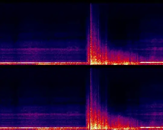

Here are some examples for taking an audio file, running it through ffmpeg, and have a video created based on some of the filters available in ffmpeg.
Examples:
spectogram:
ffmpeg -i song.mp3 -filter_complex showspectrum=mode=separate:color=intensity:slide=1:scale=cbrt -y -acodec copy video.mp4
spectogram

  • I get `Codec not supported: VLC could not decode the format " " (No description for this codec)` unless I change "mp4" to "mkv". But +1 anyway because these were helpful examples. – Ryan Aug 07 '18 at 19:18
