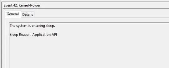

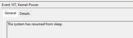

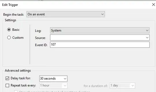

Event 107 when resumed from sleep, and 42 from entering to sleep. I just try event 107 to trigger a program when resume from sleep, and it worked
