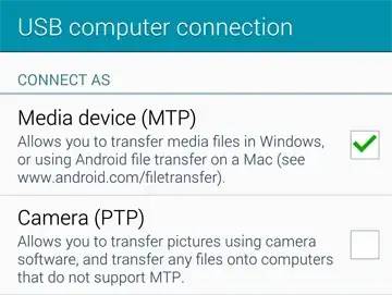

1. I do connect phone via USB 2.0 using Media Transfer Protocol to PC.
2. While using MTP, Windows recognize it as Portable device

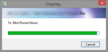

7.1 If you press «No, just copy» process gonna stack at ~95%:
7.2 If you press «Yes, convert and copy» process will like this for ever:

Problem has been solved with K-Lite Codec Pack uninstall!!! Pop-up window looks a bit differ now:
On «Yes» it transfer files without a single problem. Oh, finally but 2 days wasted. Thank you.
