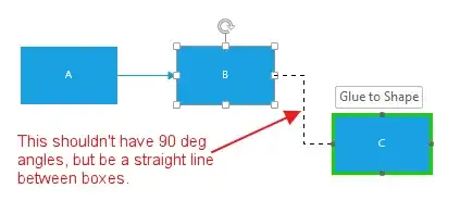

I'm creating a Visio Flowchart diagram. I want all connectors by default to be "Straight". Is there any way to set a default style for newly created connectors? Currently all my connectors are always drawn "Right Angle" initially.
Note that I'd prefer any solution to work for both drawing a connector with the corresponding Tool, and for drawing a connector through the smart interface when hovering a process block.

To put it in a picture, here's what happens now:
drawing a connector giving default Right Angles
And here's what I want to happen:
a straight connector

It looks like this has been a common question for ages ;). You can change default connector style by editing "Dynamic Connector" master in the document stencil (in your case, set it to be "straight").
To do this:
  1. Open the "Shapes" sidebar
  2. Hit the flyout icon next to "More Shapes" and select "Show Document Stencil"
  3. At the bottom a new panel shows which contains "Dynamic connector": right click it, and under "Edit Master" select "Edit Master Shape"
  4. Select the connector on your screen (should be a line with one right angle)
  5. Use the ribbon (Design > Layout > Connectors) to set it to "Straight"
  6. Close the window top left with the [X], and choose "Update the connector and all of its instances"
New connectors will now default be routed as straight connectors.

In addition to Nikolay's answer above, in Visio 2003 I couldn't find the "flyout icon" so I would add the following 2003 specific bits to the steps above:
Step 0. You need to add a dynamic connector to your document before it will show up in the Document Stencil. THEN you can edit it.
Step 1. File > Shapes > Show Document Stencil.
Step 5. In 2003 there was no ribbon in the editor, so I had to right click on the arrow and then chose "Straight Connector"
Hope this helps someone else!
