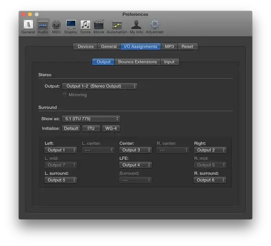

I then configured the Audio Preferences's Surround section under I/O Assignments to show as 5.1 and default to the WG-4 channel assignments as so:
Logic Pro X's I/O Assignments panel, configured to display Surround output as 5.1 using WG-4 channel assignments

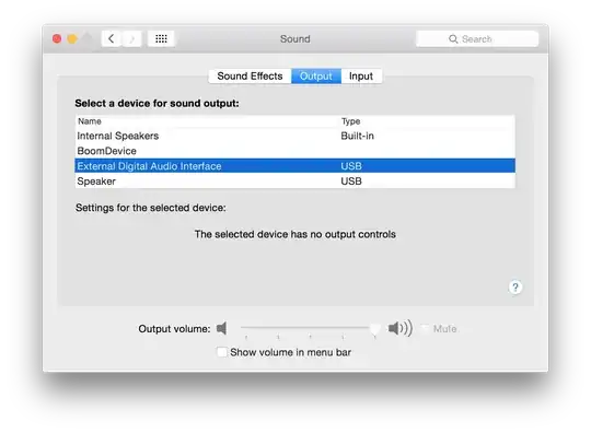

Select the External Digital Audio Interface in the Sound Preferences' Output panel. A screenshot of OS X's Sound Preferences panel with the External Digital Audio Interface selected

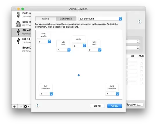

Then, click Configure Speakers and select Multichannel, and 5.1 Surround in the drop-down. The defaults are the ITU channel settings, so front left, centre, and right are channels 1-3, channel 4 is the woofer, and 5 and 6 are the rear left and right respectively. The speaker configuration screen of the Audio MIDI Setup

Finally, pop up the Audio preferences panel in Logic and select 5.1 Surround in the "Show as" drop-down and click the ITU button, which will set the channel assignments to the same ones as the defaults in the Audio MIDI Setup above. Logic Pro X's Audio preferences panel correctly configured for surround sound output
