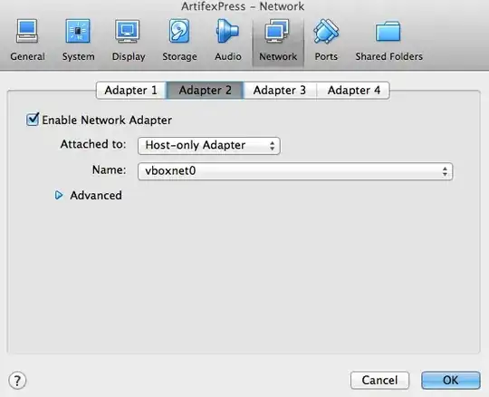

Once that is setup, I make sure the guest OS in VirtualBox has the adapter enabled like this:
Note that I have a “Host-only Adapter” designated and that adapter is associated to vboxnet0? Once that is done, the guest OS should be fully aware of the host-only setup and you should be good to go.
