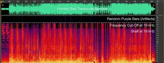

So, you are saying that if you transcode an MP3 to WAV, that it's lossless? WAV is an uncrompressed loseless format, MP3 is a 'lossy' format. Lossy formats are always compressed. When you transcode from lossy to lossless, you will end up with a file that looks lossless, but it really isn't.
You can check this by applying 'spectral analysis' on the file. The image below show a lossless file, that is transcoded from an MP3. Can you see the shelf at 16 kHz? In a uncrompressed losseless file (like WAV), the shelf shouldn't be there.
Really good information on transcoding: https://www.whatinterviewprep.com/prepare-for-the-interview/spectral-analysis/
