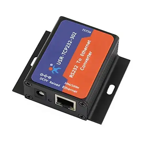

There are however serial connectors with an Ethernet server which I would recommend instead if your target exposes serial, e.g. this one:
