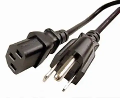

I'm planning on getting a new PSU and I was shopping online when I saw this thing.
PSU NZXT HALE90 850W
What kind of port is this? I've never seen it before, and I definitely can't find cables for this.
For reference, this is a "normal" 3 prong cable:
Black power cord

  • I honestly don't see anything strange about it. Look like your typical 3-prong power connector. – Ramhound Dec 10 '14 at 19:45
  • The prongs are side to side instead of up and down, that's odd. – New-To-IT Dec 10 '14 at 19:48
    It's like they avoided a long-time standard for no reason (expect maybe to sell you cables). I'd avoid that PSU like the plague. – Ƭᴇcʜιᴇ007 Dec 10 '14 at 19:50
  • @Ƭᴇcʜιᴇ007 The thing is, I see no spare cords for sale at their site. This is confusing me. – Kaz Wolfe Dec 10 '14 at 19:51
  • Looks proprietary...why? I don't have any idea... – Ben Plont Dec 10 '14 at 19:51
    Its just a standard 16amp IEC-C19 connector. There are tons of them on Amazon. – Ramhound Dec 10 '14 at 19:57
  • That's bizarre, I've built and used plenty of Servers, UPS and such in my life and I've NEVER seen that coupler. Anyhow, it's _A_ standard at least, so you can get them. ;) – Ƭᴇcʜιᴇ007 Dec 10 '14 at 20:01
  • @Ƭᴇcʜιᴇ007 I've settled for a nice Rosewill one, this just looked weird, and I had no idea where it came from. – Kaz Wolfe Dec 10 '14 at 20:05
    @Ƭᴇcʜιᴇ007 There are boxes of C19/C20 at my job. Old Mac G5s use them too since they're rated 10A and that's the limit for C13/C14. – arielCo Dec 11 '14 at 02:11
    @Ƭᴇcʜιᴇ007 pretty sure i've used apc ups units that use those connections. That was in europe. Quite common i thought until i saw this question. – Sirex Dec 11 '14 at 02:40
  • I have seen these plugs many times in datacenters - on the servers and on the rack Power Distribution Units, but never on a consumer machine before. – Moshe Katz Dec 15 '14 at 18:11
  • possible duplicate of [How do I identify hardware I am unfamiliar with on my computer?](http://superuser.com/questions/709913/how-do-i-identify-hardware-i-am-unfamiliar-with-on-my-computer) – Ƭᴇcʜιᴇ007 Dec 31 '14 at 14:16
29
It would appear that is a IEC 320 C19 coupler.
This coupler is used for some IT applications where higher currents are required, as for instance, on high-power workstations and servers, uninterruptible power supplies, power distribution units, large network routers, switches, blade enclosures, and similar equipment.
For North America you could use a NEMA 5-15P to IEC 320 C19 cable like this one (for example).

    The significant difference is that the C19 is rated for 16 amps and the more familiar C14 is rated for 10 amps. This kind of prong configuration change to indicate current capacity is very common in 220V NEMA plugs. – Tim Sparkles Dec 11 '14 at 01:41
    In addition, the NEMA 5-15 plug is only rated for 15 amps. Mostly not a problem since most C19 devices will draw less than that, but you may need a C19 to NEMA 5-20 for something like a 1500W PSU. – Mark Dec 11 '14 at 03:06
