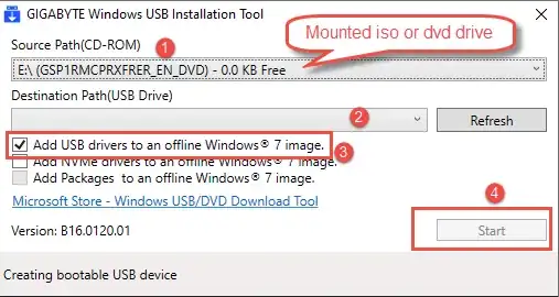

Download and create bootable USB by this tool, http://download.gigabyte.us/FileList/Utility/mb_utility_windowsimagetool.zip
Palanikumar
  • 121
    This is the correct answer. Each mobo manufacturer has installation / utilities tool that adds the necessary USB 3.0 drivers to the Windows 7 bootable USB. For example, ASUS has the "ASUS EZ Installer"; the instructions state "Based on the chipset specification, your system requires the USB driver to be preloaded in order to use USB keyboard/mouse during Windows® 7 installation. This section is a guide on preloading the USB driver and installing Windows® 7." – Special Sauce Apr 13 '21 at 05:46

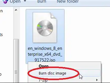

  • Instead of booting with the Win7 DVD, use a Win8.x DVD and see if the keyboard/mouse works. If the keyboard and mouse still doesn't work even on Windows 8.x setup, then it's likely something dodgy is up with your motherboard.
If you don't have a Win8.x DVD you can obtain a free enterprise evaluation ISO from Microsoft. Assuming you have access to another working PC that is!
Burn ISO
