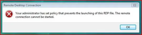

On XP, the Guest account can run the RDP client to connect to a remote RDP server, but when I try the same under Vista Business (with all updates installed) I get this:
Error
I can run mstsc manually with 'Run' on the Start Menu, but although it runs, nothing happens at all when I click 'connect'.
Everything works fine logged in as any other account, it only fails as 'Guest', and this is on multiple clean installs of Vista.
Is there something in the Local Policy that can be tweaked to allow the RDP client as Guest?

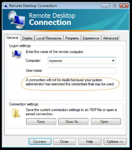

edit: there is also a message in the rdp client itself:

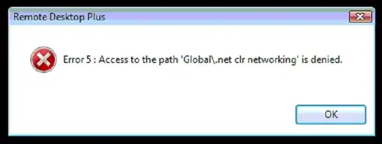

and I get this error when trying rdp+:

  • I would suggest Start>Run gpedit.msc - Since you're not on a domain, Local Group Policies - In there you should find your RDP policies and allow the Guest Account to use it. Your error tells you it's a policy issue. – Andrew Dec 18 '14 at 19:43

I've given up trying to find a solution and I'm using a workaround instead. Seeing as these machines are locked down and only required to run Remote Desktop Client, I'm comfortable with this being a bit of a hack:
  1. Create normal (limited) user called MYUSER (or whatever)
  2. Set everything up in the profile the it needs to be (eg link to .rdp file)
  3. As admin, copy C:\Users\MYUSER\NTUSER.DAT to C:\Users\Default (overwrite destination)
  4. Rename C:\Users\MYUSER\NTUSER.DAT to C:\Users\DASH\MYUSER.DAT.MAN
Basically this forces a temporary profile to be used on every login, and this profile comes from C:\Users\Default. The effect is that any changes a user makes while logged in are discarded when logging out.
