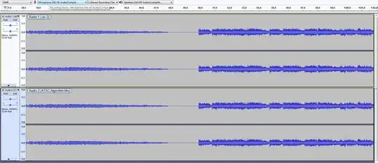

I decided to test this for certain by re-encoding the same input audio using both -ac 2 and the -af filter from Gregory's answer (the exact commands used can be seen in the footnotes to this answer).
I then compared the sizes of the resulting output files and found they were, byte-for-byte, the same size:
Finally, I opened both of the two output files in Audacity, and compared their waveforms to confirm they were identical (click to enlarge):
It therefore seems pretty conclusive that the ATSC formula detailed in Gregory's answer is the same one already implemented by FFmpeg, and that using it is entirely redundant when it does nothing that -ac 2 doesn't, and is a much more cumbersome command.
