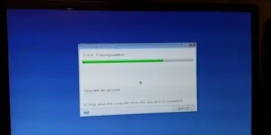

It depends what cloning software you use. Some of them provide a specific function to clone the partition on which the operating system is currently running.
The reason this is possible is that after prompting you for all the info about what cloning you want, they reboot to a special environment and perform the cloning there instead of under Windows.

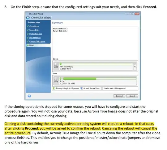

You mention it's a Crucial SSD; things may have changed since the question was asked, but today Cricual SSDs come with free Acronis True Image for Crucial, which can clone the current partition as I've described. From the Acronis user guide:
I've just used this successfully on a new Crucial SSD:
