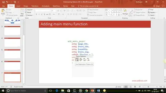

Copy the code and first paste that code into Microsoft word
Then do the formatting if necessary and then copy from word and paste back to powerpoint by right clicking and choosing use destination theme
- 121
- 3
Either way, what does “Then do the formatting if necessary” mean? – Scott - Слава Україні Apr 26 '17 at 19:10
It means if you want to do some changes of your own like aligning or indentation of code – selftaught91 Apr 26 '17 at 19:17
This was the only way that I could copy and paste code from IntelliJ (a special program used for writing code) – robert Nov 14 '19 at 04:15
