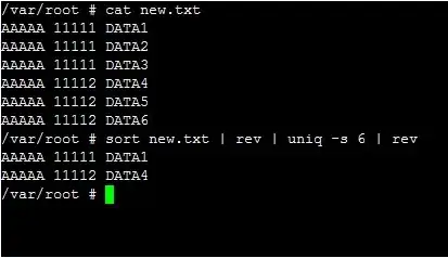

You can use the below command to sort it out
sort new.txt | rev | uniq -s 6 | rev
output of the file is as follows
Hope this helps
