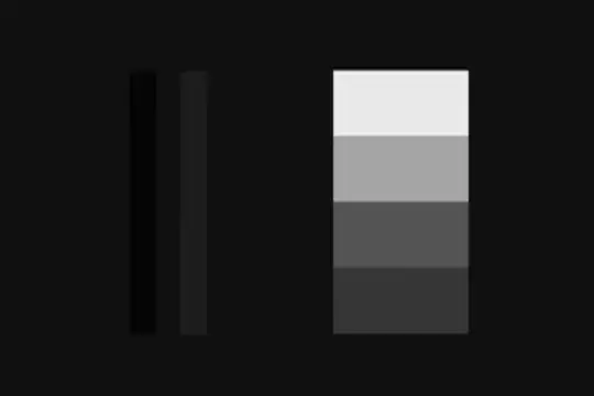

Short answer, No. Long answer, unless you are doing very intensive photo/video work or a huge videophile you will never see the benefits of a detailed calibrating. I would simply use an image such as the one below and adjust the contrast and brightness until the background looks black instead of grey and only see one black vertical bar on the left. Also, a lot of monitor calibration revolves around buying a high end monitor that is built to be calibrated.
