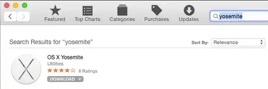

1) Downloaded the Yosemite installer from the App Store

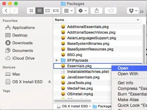

2) Show contents of "Install OS X Yosemite.app"
3) Open Contents/SharedSupport/InstallESD.dmg
4) Install Packages/Essentials.pkg

By installing Install OS X Yosemite.app -> Contents -> InstallESD.dmg -> Packages -> BSD.pkg, /usr/bin/ruby was installed on Yosemite 10.10.5.
