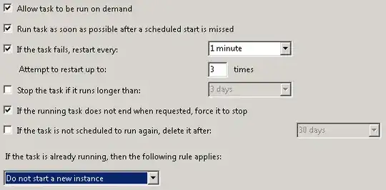

The correct way to set this up is to set the start time any time in the past, then select "Run task as soon as possible after a scheduled start is missed" in the Settings tab.
user917170
