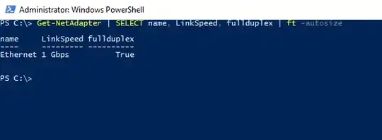

At command prompt:
powershell "Get-NetAdapter | SELECT name, fullduplex | where name -eq 'card name'"
Enjoy.
Looks like the documentation at https://msdn.microsoft.com/en-us/library/hh968170(v=vs.85).aspx confirms that this is the operating status not the selected setting. Glad to see that there is now a way to do this 8 years later reliably. – Scott Markwell May 01 '17 at 04:13
Get-NetAdapter needs Windows 8 or later (re: https://stackoverflow.com/a/27213645/) – im_chc Oct 15 '18 at 05:29
