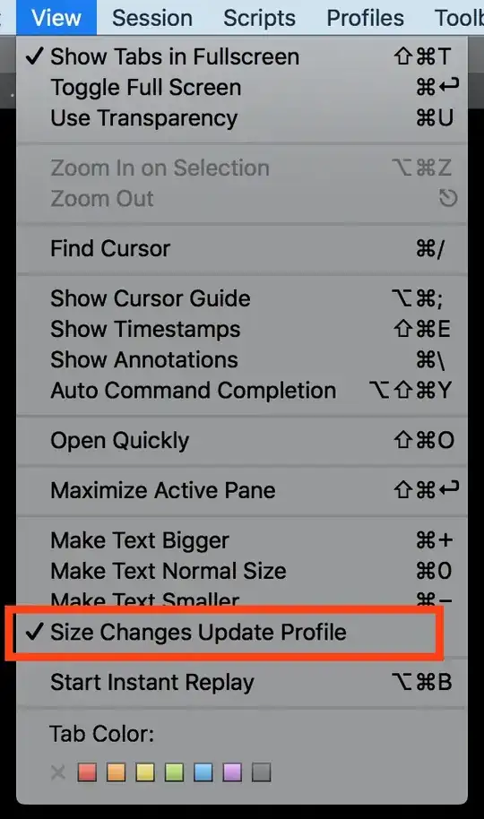

26
In the current iTerm2 (version 3.3.7), there's View > Size Changes Update Profile which solves the issue:
To change the font size regardless of profile, see this iTerm2 issue where a script is provided.

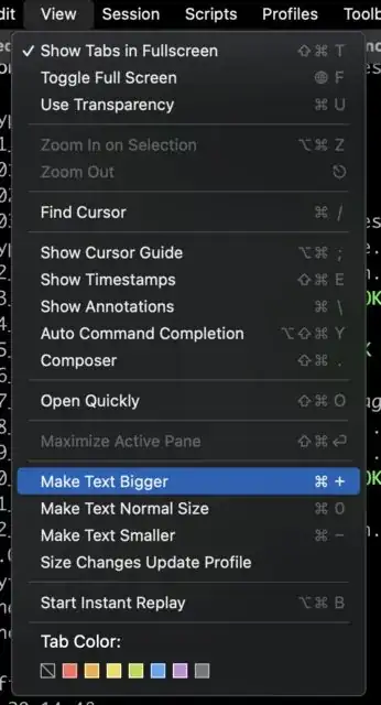

For version iTerm2, version - 3.4.17 You can use the shortcut + +
Or you can go to
View -> Make Text Bigger
