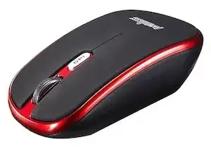

I have this Perixx PERIMICE-710R USB wireless mouse:
Perixx Perimice-710R
