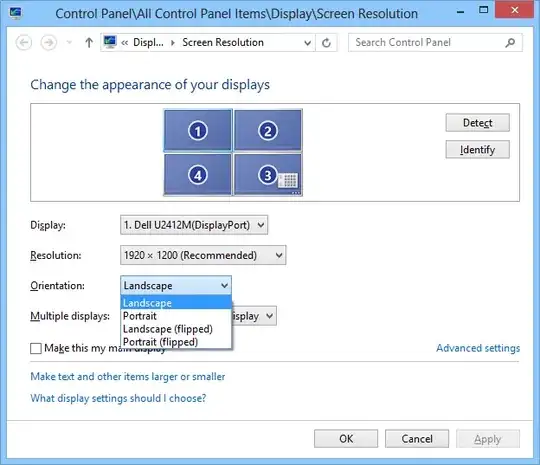

Assuming you have a natively widescreen monitor:
It might sound silly but you need more vertical screen real estate so the only temporary solution would be to rotate your screen by 90 degrees.
Set the orientation to portrait and then reverse the resolution setting. In my screenshot I would need to set the resolution to 1200x1920 if I want to use portrait mode.
The ultimate solution is to get the software fixed or get a monitor with more vertical pixels.
Good luck!
