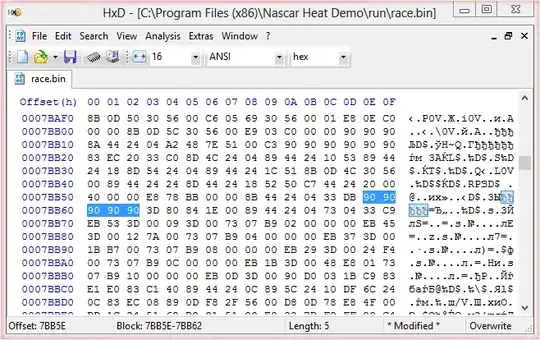

To remove it we need to replace it with NOP instructions (hex: 90). I already know the file offset, but it can be diferent in your executable. Fortunately, hex-string 0500600900 is unique in my race.bin and probably in yours. So get hex-editor (I recommend HxD: it's free, portable and easy to use) and open your bin file.
Do a hex-string search:
hex-string search
Once hex-string is found
hex-string found
Replace it with 90
Patch!
Save the file. HxD will automatically create backup of the file, wich you can restore if something goes wrong.
