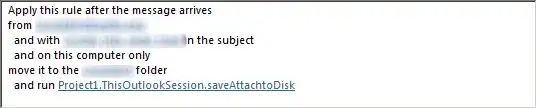

If you want to process attachments on specific e-mails, this is what I use. It works perfectly for me in Outlook 2013:
Public Sub saveAttachtoDisk(itm As Outlook.MailItem)
Dim objAtt As Outlook.Attachment
Dim saveFolder As String
saveFolder = "c:\temp"
     For Each objAtt In itm.Attachments
          objAtt.SaveAsFile saveFolder & "\" & objAtt.DisplayName
          Set objAtt = Nothing
     Next
End Sub
The last part of the rule is the run a script.

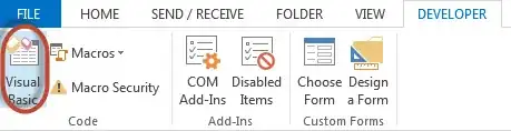

For others that are not familiar with Outlook VBA, you need to bring up the Developer Ribbon.
Paste the code above, save the VBA, then reference it in your rule.
