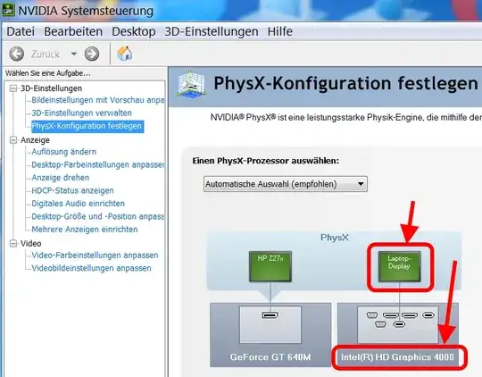

Are you sure that your laptop screen works through nvidia and not the cpu's internal GPU? You can check that through external monitor and nvidia settings:

  • When I go to nvidia settings from external monitor I can only see the external monitor and not my laptop's so I cannot configure anything. win+p doesnt solve the problem either. – TheCrafter Mar 02 '15 at 22:36
  • And what do you see by right clicking the desktop and choosing "screen resolution". Only one screen, too? – mgutt Mar 03 '15 at 01:57
  • Yes. Only one. By the way check the post again I have one more status update to the problem. – TheCrafter Mar 03 '15 at 08:21
  • Ok, this is what I proposed you in 2.). But you missed to answer one important question: If the laptop screen is working, which GPU delivers the signal? I will attach a screenshot of the nvidia settings where you can see clearly which GPU is working. – mgutt Mar 03 '15 at 12:57
  • No laptop works through Intel HD graphics but I cannot turn it to NVIDIA. It won't let me... – TheCrafter Mar 03 '15 at 13:28
  • Thats a usual behaviour on many laptops. I updated my post again. Maybe you will find something useful. Finally I think the cable connection between screen and mainboard is not properly shielded or because of the folding mechanism damaged somehow. – mgutt Mar 03 '15 at 14:42
