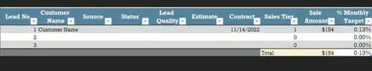

I have had this issue before. This seems to be an issue caused by having a Totals row, but that's only a guess. This will still clear the problem of formatting.
  1. Select the entire table, except the headers, but including the Totals row.
  2. On the Home tab, click the small dropdown arrow next to the Clear button on the Editing submenu, then choose Clear Formats from the list.
  3. With the formats cleared, select the last cell not in the Totals row and press Tab to create a new row. It should be in the General format.
  4. Select the column to be formatting, excluding header, but including cell from Totals row.
  5. Format as desired by pressing Ctrl + 1 or using Format Cells from context menu.
  6. Add new row again. It should be in your desired format.
  7. Change the Total cell in that row to its desired format.
  8. Final test, add another new row. It should still be in the correct format from step #6, while the Total cell is in its correct format as well.
