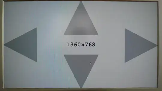

In the nVidia drivers for Windows, there's a setting for overscan compensation where the video card is still sending 1920x1080, but is downscaling your 1920x1080 desktop to make up for the edges your TV is chopping off. It looks like this:
This isn't the best option since you're downsampling your desktop, then the TV's upsampling it again in the overscan function. It'd be best to see if you can just turn overscanning off in your TV.
The triangles let you tell the driver how much area is visible (and conversely, how much is chopped off).
