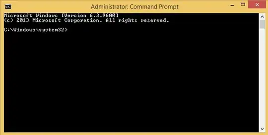

Well, here's something you could do.
If on Windows Vista/7: open your start menu, type cmd omitting the quotes, right click on cmd (looks like a black icon with c:\ on it) select Run As Administrator
If on Windows 8+: press WinKey + F, type cmd omitting the quotes, right click on cmd (looks like a black icon with c:\ on it) select Run As Administrator
Once in the Command Prompt it should look something like this:
Command Prompt
NB: I use Windows 8.1 Update, yours might look slightly different.
Next, we need to type this:
taskkill /F /IM AvastSvc.exe
This tells Windows to launch a command, taskkill (Task Killer), tells taskkill that it needs to /Force the program closed, and that the /IMage name is AvastSvc.exe
Once done, you can safely close the Command Prompt.
td512
  • 5,031
    No it can't be done. It fails just like trying to terminate it from the task manager and yields the error whose second line is Reason:Aessisdenied.Reason: Access is denied. Just to be sure: I started it with Admin privileges just as you said. – Shashank Sawant Mar 28 '15 at 03:48
  • Have you turned Avasts self protection off? OR... you could uninstall Avast. – td512 Mar 28 '15 at 03:53
