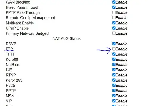

Yes, its bcos of NAT ALG on my Skyworth Router. I disabled it and it fixed the issue instantly. filezilla inactivity failed to retreive directory listing
It was enabled by default, I unchecked it. Now Filezilla is working perfect. You guys might find some similar options, so this is working solution. Thanks to fwilhelmsson for the idea.
